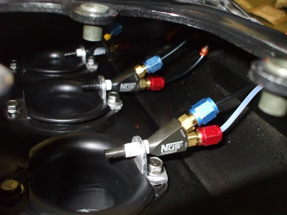

this is what i have done on my wet kit so far in the air box. the majority of the lines, the solenoids, distribution blocks are outside the air box/frame. just the foggers and brackets and a small length of line are actually in the airbox. the lines run pretty much straight back to 8 seperately drilled holes(sealed with silicone) in the back of the airbox. the lines will be replaced by stainless hard lines as soon as i recieve them from Gixx1300R(the guy selling the spraybars). you could do a dry kit this way too, just run the proper dry nozzels. just be sure to have a nitrous map in your PC. in my opinion it would distribute nitrous as evenly as a spraybar IF done properly. if you dont know what you are doing, the spraybar is a proven and tested option

this is the Nozzle you would want to do a dry kit that is set up similar to my wet kit
[img] http://www.jegs.com/images/photos/700/741/741-13500.jpg [/img]
the custom nozzles at the first of the thread that slykitty has would not distribute nitrous evenly. it may be ok for a small shot(25hp), but dont risk it guys. if you use a nozzle like that, have it way up in the ram air tubes so its evenly mixed before it even gets to the air filters

well, my setup works. proven today at the track. prev best was a [email protected] on motor. today i ran a 9.02 @ 157. should run 8.90s with better tuning, it was super rich.
