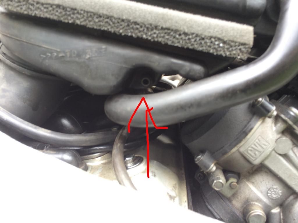

My zx7 has been sitting in a garage for about a year and I finally managed to make it start! At first it was running good with the choke on and then after about 10minutes when i removed the choke it stalled... i try to start it again and it was backfiring like crazy until it started again and now it was puffing white smoke like crazy... could it be flooded? what could have caused that to happen??
Here is a quick video on what the bike does:
Another problem that i have that might be related is i have 2 hoes missing unplugged and i really have no clue where they could go:banghead: the second picture is on the side of the airbox
If someone could help it would be really appreciated!
Thanks in advance :thumbup:

Clean the carbs and put a vaccuum cap on the tit on the motor. The one in the airbox ain't a big deal and might be a drain...problem solved.

Discussion Starter #3
ok thanks bro will do!! :thumbup: can i clean it myself or i gotta send it to someone that will disemble it completely ??
