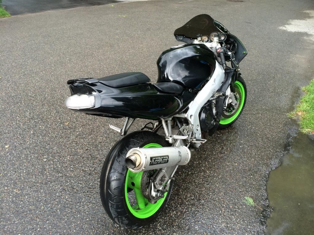

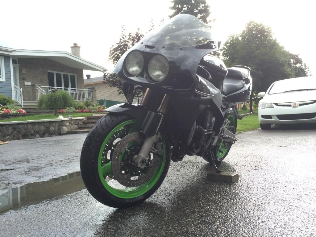

Im new to the bike scene and ive been around cars and tuning for quite a while now! i just got my hands on a 1995 kawasaki zx7r. Did a trade for a bodywork job so i didnt really pay the bike... This his how he looks now
Im planning in doing a full restoration/custom upgrades and i will eventually post a build thread up on this forum :crazyloco: But first there is a small problem with the bike and i want to light up my path and find the problem to make the bike run before starting to take evrything apart...
What happened: The guy that had the bike before me drove it and the valve cover gasket popped out spreading oil everywhere... My question is what could have caused that to happenned?? too much pressur in the engine? vaccuum hose blocked? i looked on forum real quick and some people says it could be a stator problem on injection bikes...but mine is carburated :headscratch: any ideas??? it would be really appreciated if you guys could give me ideas!! PS: i have the service manual if it helps in any cases :lol:
