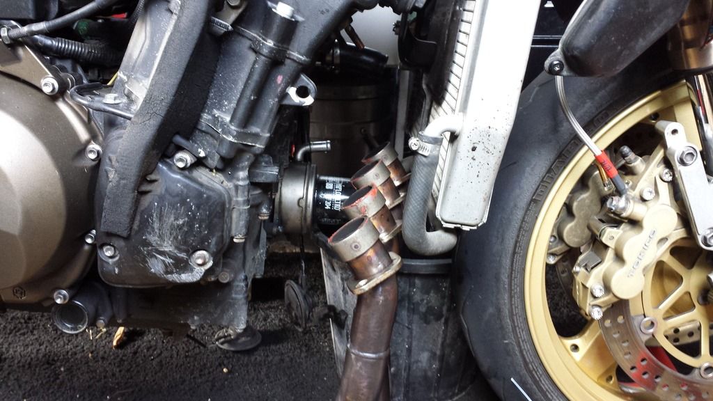

The aim is to keep the turbo up nice and high and return the oil back into the side of the sump without the use of a pump, and not remove/relocate the oil filter/cooler. After removing my muzzy exhaust I positioned the turbo and worked out some angles and positions.
Then I positioned it in a final location after looking at the exhaust run and the inlet through the fairing and made this.
I am not a welder, but I made and shaped all the sections to fit. Happy with the position. Short radius 1.5 inch stainless bends and some straight pipe. Flanges are mild steel. I would make the cylinder head flange from thicker 5-6mm plate instead off 3 if doing it again. 3mm distorts to much.
